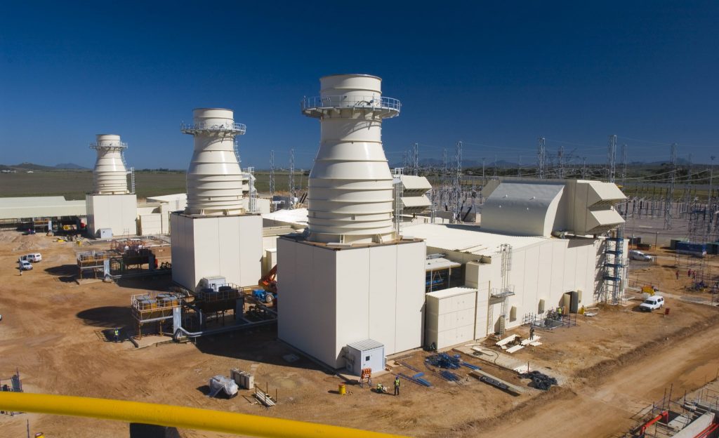

As for the 2nd question - that's a rather long answer to a deceivingly simple question.
I'll attempt to make a brief answer but that really needs to be whole separate writeup.
If we look at a statement from Eskom where they have load shed at night:
You'll see that they load shed at night mainly to replenish emergency reserves.
Let's break that down.
Firstly what does that mean, and what are emergency reserves?
Eskom keeps some storage as a backup in case they need to call on it.
This could be things like Diesel or Gas, or it could be water (i.e. in pumped hydro).
They could be waiting on deliveries for the former, or have used up all the latter.
If they need to replenish emergency reserves, it usually means that they've been running the system far in excess of where its supposed to be run. This is usually done at election time for example, where the ANC government explicitly tells Eskom no load shedding.
This costs the country a huge amount, as Eskom then needs to use diesel or gas to power things.
The short version is - we don't have enough capacity to run daytime in some cases.
Our alleged total capacity is 45GW, however with ANC misappropriating maintenance funds for decades, this is down to 25-30GW, sometimes even less.
We can compensate for around 2GW.h or so using pumped storage or diesel/gas generation, but this means we have no margin for the next day.
Assuming we have a serious outage and generation sits at 20GW, but we really need 25GW for the day, Eskom will both load shed, and use backup generation. This leads to having no margin for the next days issues, so while overnight load is lower (typically 10GW.h lower), they may need to use all that excess just to refill pumped storage so it can be used again.
In reality its more involved and complicated, but thats the gist of things.
