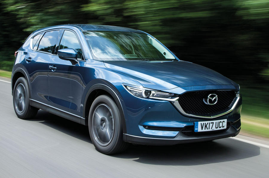

Nearly new buying guide: Mazda CX-5
Family SUV for independent thinkers now starts at around £9000
In the crowded second-hand family SUV sector, the Mazda CX-5 stands out as a stylish, well-equipped, reliable and fun-to-drive choice. The current model was launched in late 2017. Forecourt prices start at around £9000 for a high-mileage 2017 diesel but really get going from around £11,500 for ones with fewer miles.
The range is simple. Starting with the trims, from launch there were just two, both well equipped, called SE-L Nav and Sport Nav. In early 2019, they became more enhanced SE-L+ and Sport Nav+ while a new one called GT Sport Nav+ joined the line-up.
The engines are no less straightforward. From launch, there was a single petrol, a 163bhp 2.0-litre unit (which was joined only recently by a 191bhp 2.5-litre) and a choice of two 2.2-litre diesels, one producing 148bhp and the other 173bhp. Later on, the 173bhp diesel was uprated to 181bhp. An automatic gearbox has been an option throughout.
Notice anything unusual? It’s surely those big engines. While other car makers have been busily downsizing and uprating with the aid of turbochargers and hybrid powertrains, Mazda has stuck to the mantra of ‘there’s no replacement for displacement’. Thankfully, they’re all reasonably efficient.
CX-5 1.jpg CX-5 2.jpg CX-5 3.jpg CX-5 4.jpg CX-5 5.jpg CX-5 6.jpg CX-5 7.jpg CX-5 8.jpg
