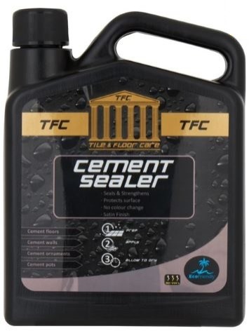

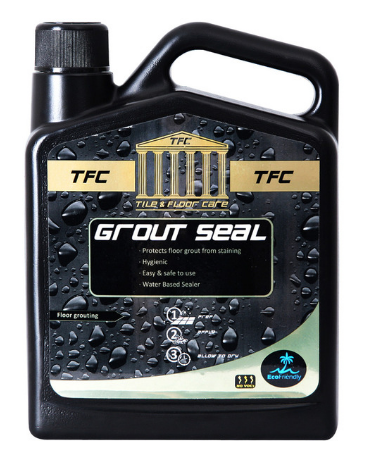

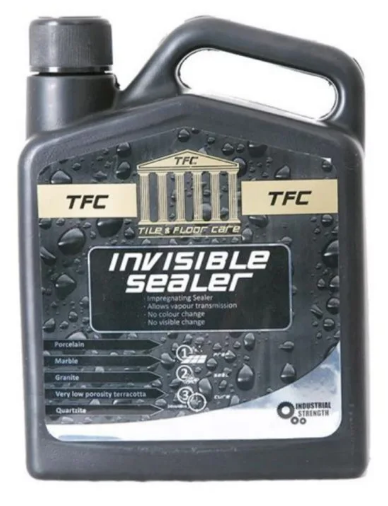

no need to remove the tiles or grout, you can seal the whole area, the water is penetrating through the grout... so whoever did your grouting didn't do it correctly, as a mention you can't use water when mixing waterproof grout... anyway too late for that now. I do love how the contractor blames the tiling damaging the membrane, I would have asked him, "how did the water get to the membrane in the first place?"
just have a look at TFC products at the hardware store, they are expensive. They make a whole bunch of different sealers.. I would find one that best suits your needs and then paint on about 3 coats.
TFC - Grout Seal
TFC Sealer Cement | Agrimark
TFC - Invisible Sealer 1L
TFC Smart Seal 1L - Habitat Potch
TFC - Grout Seal
No amount of sealant over the tiles is going to stop the water.
The only way to fix this is to remove all the tiles and do it correctly.
