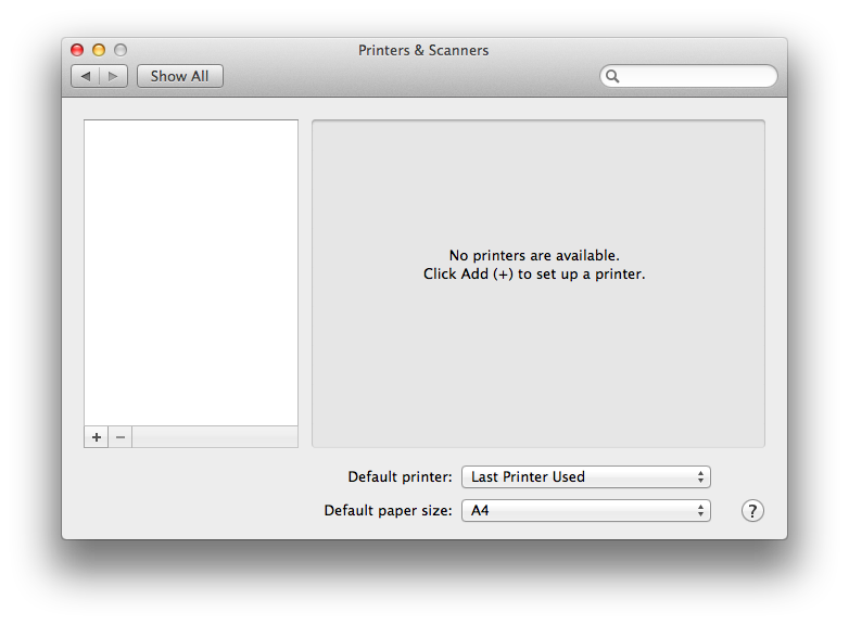

I have a new MBP I bought recently, which doesn't yet have the printer configured or the software installed, so this should be straight forard. Start her up, head over to the System Preferences, cand lick the Printers & Scanners icon:
Click on the + in the bottom left. It should show you something like this:

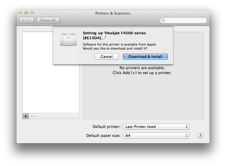

Click on the printer name, and you should be presented with the option to Download and Install - do that:

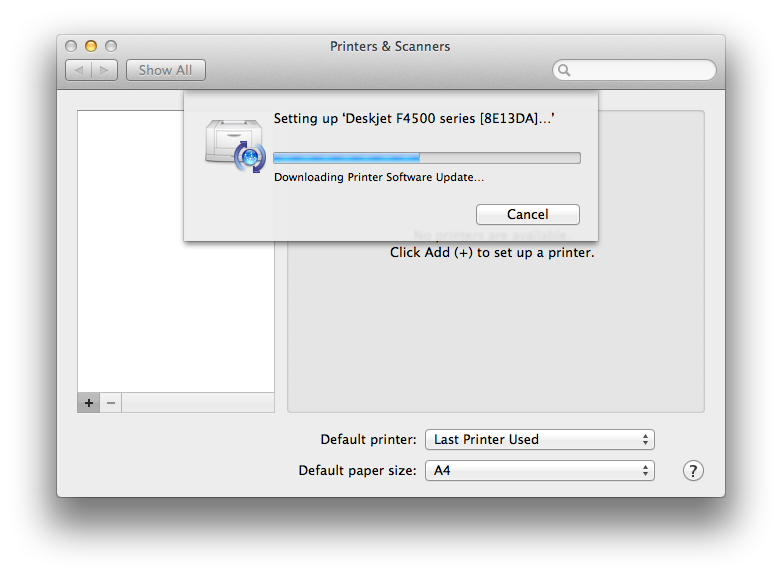

It will download the driver...
...and install the driver...

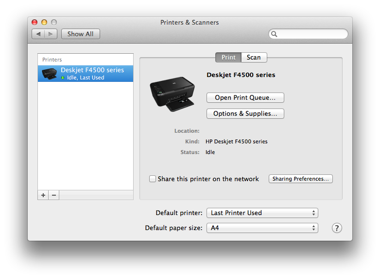

...and next thing you know, the printer is ready to use:
Simples ;)
