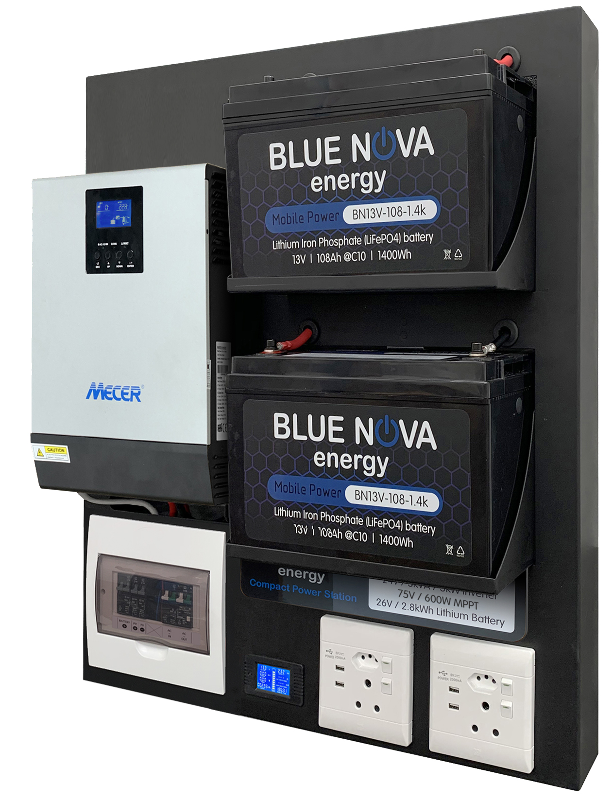

Your big inverter and other stuff later plan won't solve your current problem, go for a quality package that you can still use when you have installed a more sophisticated system or sell for a decent amount. Or spend slightly more and start on a good footing, R35k won't work.
Something like this,
ProfA
I'd rather spend the R50k than spend R35k and then another R50k on top of that in a year or two, yes I could sell the old stuff but getting more than 60% of the value back would be pushing it, and then having to sell a relatively niche product as well would be tricky.
The one you linked would probably not be sufficient for my needs, 3kW is a bit lightweight for my usage I think. And all it is is an inverter, a DB, some batteries mounted to a plate by the looks of things?
Yes, it is a full plug n play solution.
I get you, whatever you do make sure it can cater for your current needs because R35k is just good enough for a 8kW inverter if you are going for the popular Sunsynk.
If I was in your position I would go for a 5kW inverter that is capable of being paralleled at a later stage, R35k would easily get you one and a 3.5 to 5kWh battery, also make sure to go for a brand that supports scalability.
Do note that even if you get the 8kW inverter you are not necessarily going to be able to run 8kW worth of load on it, you would need a massive battery for that, so for now it would probably be an 8kW that is only good for about 3kW depending on what battery you can get in your budget.
