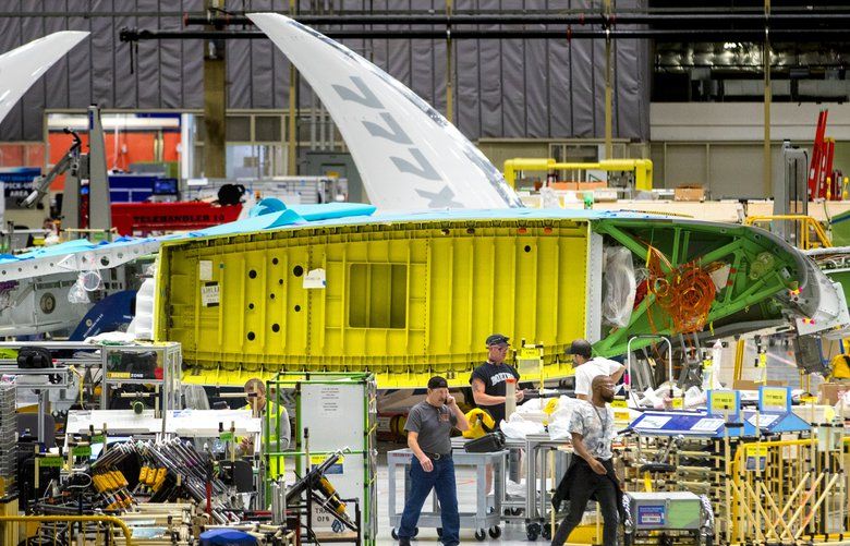

Boeing 777X’s fuselage split dramatically during September stress test - The Seattle Times
748027
Boeing got an unexpected jolt in September when engineers in Everett put the new 777X airframe through an extreme test of its structural strength.
Just as the test approached its target stress level, an explosive depressurisation tore through the fuselage.
Boeing has kept the details secret, but photos obtained by the Seattle Times show that the extent of the damage was greater than previously disclosed and earlier reports were wrong about crucial details.
The test plane is a complete write-off, its fuselage skin ripped wide open just behind the wing.
A passenger door that blew out and fell to the factory floor was a secondary impact of the initial rupture, which was located far below the door.
The relatively good news for Boeing is that because the test failed so explosively at just 1% shy of meeting federal requirements, it will almost certainly not have to do a retest.
Regulators will likely allow it to prove by analysis that it’s enough to reinforce the fuselage in the localised area where it failed.
Asked for comment, Boeing said in a statement Tuesday that while it has not yet completed a detailed analysis of the incident, “what we’ve seen to date reinforces our prior assessment that this will not have a significant impact on the design or our preparations for first flight.”
Boeing spokesman Paul Bergman said the test result won’t add to the program delays already caused by problems in development of the jet’s GE9X engine.
He said the 777X should still fly for the first time in early 2020 and the first will be delivered to an airline in 2021.
