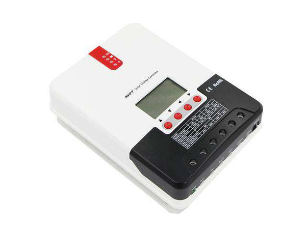

I would like to add 1 or 2 Canadian solar 395w solar panels to keep the batteries topped up during day time loadshedding to try get more life out of the batteries, i dont pull more than 300w at any one time either way so it will be 90% running straight from solar. Now im not 100% sure if this can be done. Do i only need to get an external charge controller, connect the panels to the controller and then the contoller to the batteries and unplug from eskom?

Yes, you need an external mppt controller for the panels to plug into and the controller plugged into the battery, then set the charge voltages of the controller slightly higher than the inverter charger so solar takes preference.
Could you suggest an mppt controller that wont break the bank. The PWM controllers are like a quarter of the price of an mppt.
