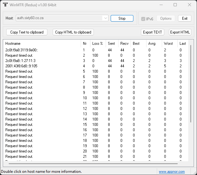

Hi @CoolEscalator
Please could you kindly take a look at the sixty60 app it doesn't want to load over IPv6 so the app just hangs
This seems to be for auth.sixty60.co.za
IPV4 is ok
WARP
Hi @CoolEscalator
IPV4 is ok
WARP

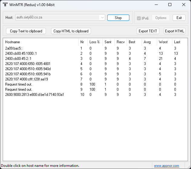

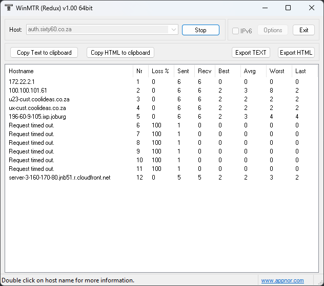

Yeah I have also noticed that some sites dont get picked up locally yet. Some of the things goes via UK when using IPv6. But when v6 is switched off it gets picked up locally via V4 again
HI there, are you able to share some of these destinations with me?
Would be happy to take a look.
@adam_g were still looking into auth.sixty60.co.za, I do see when I ping the V6 addess on our looking glass it resolves , however latency seems to be 312ms, so not so ideal (lg.cisp.co.za)
