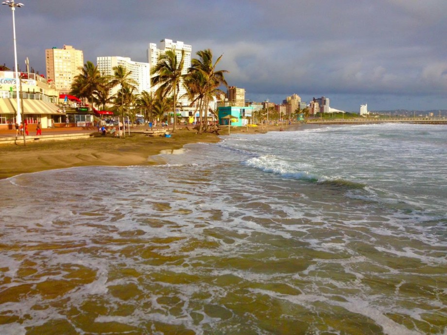

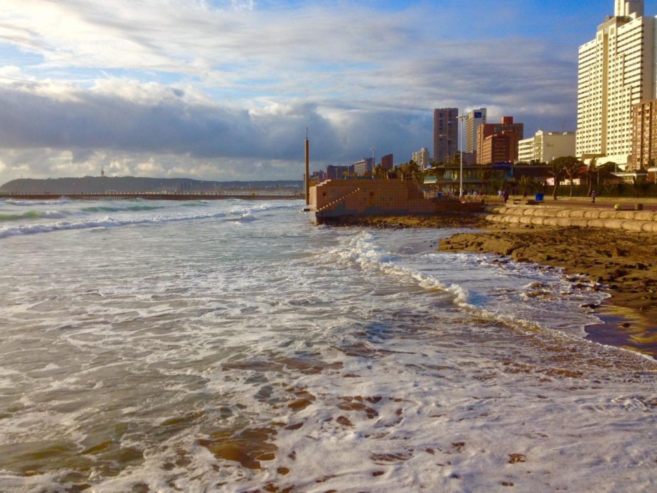

That pic on the article, you can see the reason for Durban's beach disappearing. To build that wide walk way, they had to throw rocks and paving there, therefore, less beach. Same happened at Strand(Somer-Set West).
Nope, it was pretty much always that wide, the piers have been there for yonks and have not moved. Walkway is/was existing land and they did not reclaim beach to build it. Go look at some old arial photos going back to 19voetsek and you'll see it did not change over the years.

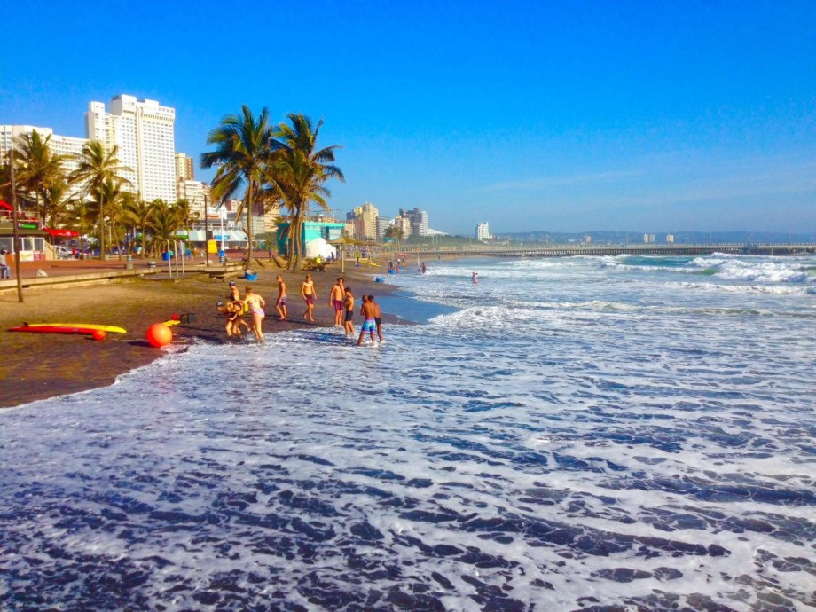

Not so long ago,
That grey building on the beach in front of the swimming pools is the pumphouse used to pump sand onto the beaches.
Now,
That's the very same pumphouse

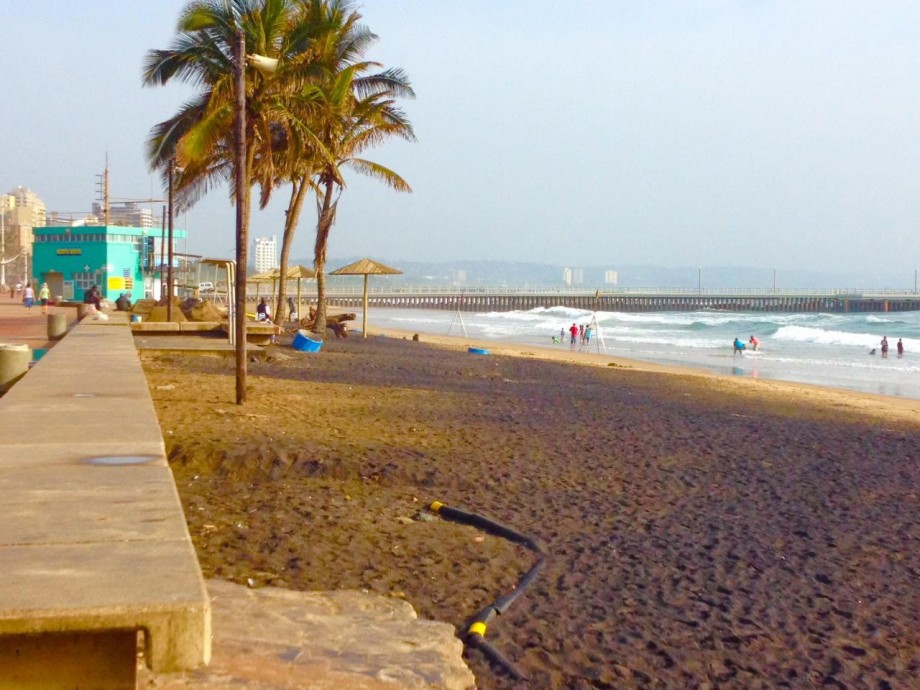

Durban beaches sand replenishment operation under way
Durban - City engineers and a private contractor, Suntech, have reacted swiftly to the threat of sand erosion on the North Beach promenade and lifeguard tower.
Since Friday, sand has been pumped from a dredger to the affected beaches.
Engineers had fitted a pipe to the dredger anchored a few kilometres offshore.
The sand is then pumped from the dredger into the pipe which has an outlet on one of the affected beaches.
Hundreds of curious onlookers took photographs and filmed the sand replenishment operation yesterday.
More at : https://www.iol.co.za/dailynews/news/durban-beaches-sand-replenishment-operation-under-way-14647168

R15 million 'emergency bill' for Durban beach repair scheme
Five Durban beaches are finally getting a badly-needed infusion of sand – but the emergency operation will cost ratepayers at least R15-million in extra costs because of lengthy failures by the municipality and Transnet to repair the city’s sand-pumping scheme.
Last week‚ a massive black plastic pipeline‚ reminiscent of a giant sea serpent‚ began to spew out a slurry of sea water onto the severely-eroded remnants of North Beach.
Over the next three weeks‚ the temporary ship-to-shore pipeline will be shifted to four other beaches - Dairy‚ Suncoast‚ Country Club and Sunkist - to replenish the sand and also prevent Durban’s popular promenade from washing into the Indian Ocean. All these beaches will be closed off in stages and then re-opened as the sand pumping and levelling process proceeds.
The massive operation follows severe erosion over recent years exacerbated by the equinox spring high tides in February.City officials have sought to blame the erosion on climate change and the proliferation of illegal sand-mining operations in several KwaZulu-Natal rivers‚ but enquiries by TimesLIVE suggest that the immediate cause has been the ten-year delay by Transnet and eThekwini Municipality to reinstate an extensive land-based sand pumping network that was commissioned in the early 1980s.
Largely because the massive Durban harbour entrance piers prevent sand from moving up the coast to replenish naturally eroded beaches‚ the municipality has been pumping sand onto local beaches for several decades. This is acknowledged on the city’s own website‚ which records that the first artificial sand replenishment scheme began in 1935.
However‚ early schemes did not solve the erosion problem and eventually a major 3.5km pumping scheme was designed by the Council for Scientific and Industrial Research (CSIR) to ensure that dredged sand could be pumped from the harbour as far north as Minitown.
More at: https://www.timeslive.co.za/news/so...mergency-bill-for-durban-beach-repair-scheme/
