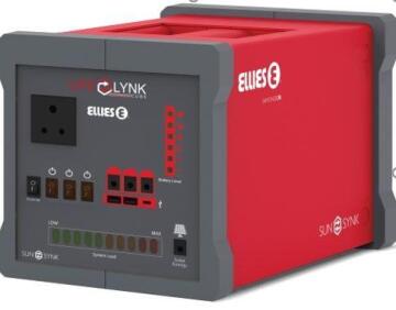

Ellies LifeLynk Power Bank

Good day all
Anyone have any experience with any of these?
Doesn't look too bad, sadly no experience, however, for only 500wh for that price is a big much. You could probably grab a decent 12v 100-120Ah deep cycle + 1kva (1000W) inverter as a bundle deal from some electrical places for R4999 or the same price.
105Ah * 12v = 1260Wh of usage, because it's Led Acid (or GEL) you can really only drain it down to 50% so 1260/2 = 630Wh of usable power. Not 100% accurate but it's around that. So you would end up with around 100Wh more of power and the biggest thing is you can double it by adding another battery down the line.
So you could just grab like second battery and reach 1200Wh with it.
But, you do pay for how easy it is to set up that Lifelynk unit. Geewiz also still sells those mecer 100Ah backup solutions for R4999, which is still a decent entry-level point.

Thanks allot sir, not clued up with this stuff. I live in a flat so I cant really do any installations ], I just need something that I can connect when theres load shedding. I just need to power an ONT, WIFI router and possibly a laptop.

Using the Ellies Cube Mini to power a router and fiber ONT, works great
