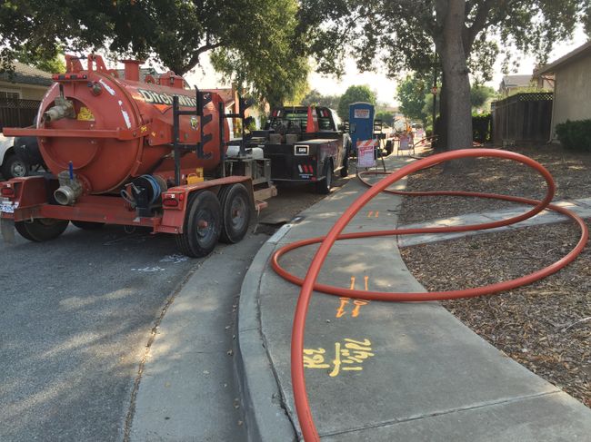

So on the trenching issues. Why are they not using directional drilling? It would take them 4 days to do a street with 1 machine. If it is even that much.
I mean with underground detection services, directional drilling... surely its a lot safer and quicker to use technology.
instead of 200 guys with shovels
Toxxyc
Dec 12, 2012
5,100
Directional drilling is incredibly expensive. So expensive, in fact, that it's only signed off for the crossing of major roads or driveways where there is no chance to get by with trenching.
D
Deleted member 369928
Guest
But is it really?
The machines cost R1.2Mil average. And pays itself off in 6 months if you roll out 42 areas. Which can be done with the machine and a little planning.
Toxxyc
Dec 12, 2012
5,100
Yes. You also can only drill for so far. You can't do hundreds of meters in one go.
