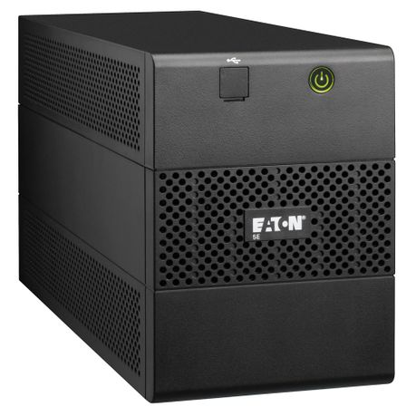

If it were me and i just wanted to run those 2 items and not strain my UPS battery i would spend R1099 on something like this.
https://www.takealot.com/eaton-5e-ups-1100va-230v/PLID47486926
