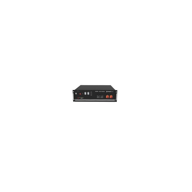

wingnut771
Feb 15, 2011
28,144
2 of these for now. 9.6kwh
only 3500 cycles, what about this, 4 grand more but 6000 cycles although i see it's out of stock:
or, also 6000 cycles:

see my update, also look at pylontech.
Looking at the Dyness 9.6kw unit
It works with the Deye inverter which seems to be another rebranded sunsynk inverter.
