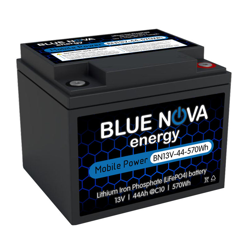

Going around in circles trying to figure out what I need power wise
Layer Cake
Member
Jul 6, 2022
22
I'm getting myself very confused here trying to figure out what sized system/battery I need, using a battery calculator drawing 200watts on a 220volt system draws 0.91 amps, so would one of these be sufficient to run what I need for 2 hours?
I would also need an inverter and battery charger but I'm trying to keep the setup below R6000, any input would be appreciated and yes I've tried to read through loads of the threads but there seems to be a lot of incorrect information in them too, leading to more confusion.
Or am I safer with going with a plug and play setup like this gizzu

No. 200W x 4h = 800Wh. That's a 570Wh battery. 570Wh is less than 800Wh. That is ignoring things like not entirely discharging the battery and such.
