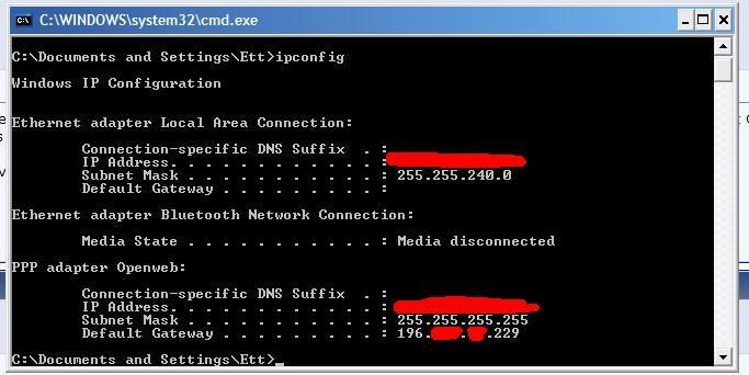

Hmmm, well this is what i get from ipconfig:
Why do i get no address at default gateway? :(

Hmmm how peculiar. At the command prompt, try "tracert google.com" - the first entry in the list (hop 1) should be your router. If still not... is your router in bridge mode? Ie. do you ever have to hit a "Connect" button or something similar on your computer to get onto the net?
Edit: Only IP it is of any use to block out (red mspaint or whatever) is your public IP, that is the one listed under Openweb - IP Address. The rest would be helpful to solve your problem and pose no security risk!

a) Do you ever use a screen like this to get onto the net? If so then you're definitely in bridge mode.
b) What is the first IP address that you have blocked out in the ipconfig screen? There is no way anyone can hack you with that, I promise.

The first IP i see is 192.168.11.183
(putting that in my browser yilded a blank page :( )
