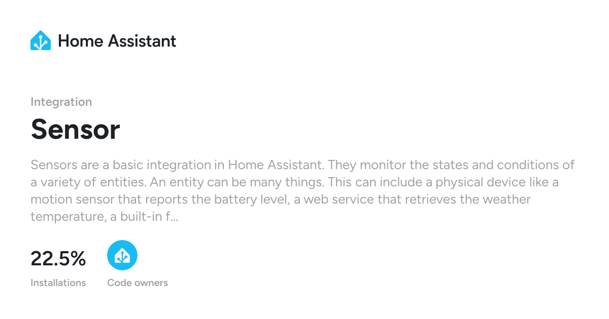

In my code the device class is set to sensor, HA picks this up from the fact that my file name is sensor.py.
The sensors works correctly in all other ways I can see.
Entity type would be sensor. Device class would be temperature, humidity or battery.
Veroland
Aug 24, 2005
6,304
Entity type would be sensor. Device class would be temperatuur, humidity or battery.
You sir, are a bloody genius!
I got so bugged down in the details I forgot about the bigger picture. Just added the device class to my entity and it works
Code:
    @property
    def device_class(self):
        return DEVICE_CLASS_TEMPERATURE;
