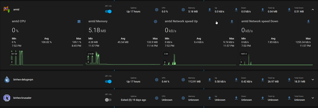

Sharing this here, as I thought it was a nice find to show a device which has multiple sensors/entities....
Currently using the same way as the example for my docker images.
