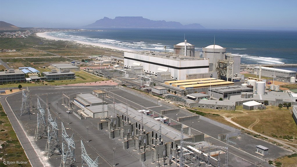

Koeberg reactor has to be taken offline for another 200 days

It is not immediately clear why Eskom and/or the NNR would require yet another 200-day shutdown. However, Eskom has indicated to EE Business Intelligence that:
Outage 127 is a planned long-duration maintenance outage (in accordance with our production plan) which will be of 200 days duration, wherein we are planning to perform identified maintenance and inspection activities including, for example, the routine 10-yearly containment integrated leak rate test.

Koeberg Unit 1 currently has welding problems on some of the non-critical lines. Some have failed their X-ray tests several times. There is also concrete to be replaced that was damaged when removing the old SG's. Looks like this Outage will finish some time early October 2023 according to the site grapevine.
