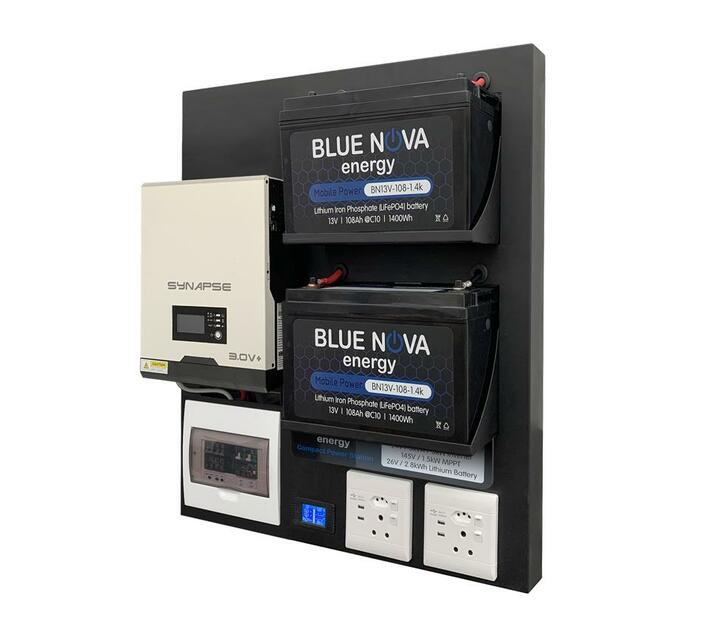

Here you go.
BlueNova batteries built locally, in Somerset West.
My retired dad had CPS3000 installed two years ago. Zero issues, no loadshedding for him.
No microwave, kettle, toaster, hairdryers, geyser, oven, stove, dishwasher, washing machine use either.

Thanks for the info.
