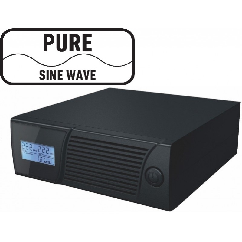

So lightning killed the Mecer amongst other things, and Insurance paid out. Now since we don't have load shedding it is not first on the list, but I think I will replace it just for incase of load shedding or other power outages.
I will spend more or less the same R2,5K. Only things run on the inverter is Routers/fiber system, tv, garage door motor and 2 lights. I have a 200ah lead acid battery in great shape, so not going to replace that now.
So question. Should I just buy another Mecer. Or will these be beter.
This seems to have Lithium compatible and is pure sinewave.
Or something like this. Would it work with a Lead acid battery? Can you plug a solar panel in. Do it need to be connected to your DB( I dont see a plug on it).
Any other suggestions?

The second one seems more efficient and more features like mppt solar, yes LA battery should work.

yea take the second one, can ad a line with a plug input and a line with multi adapter as output
and run it like a mecer, just head the max load of the plug ie 16A if bypassing when overloading
buying something that is solar capable is a must if spending mony on an inverter imo
cause that helps reduce eskom bill, and actually returns the expense
LOL there is so little stuff on that inverter, not going to save any money. I am more interested in putting a solar panel up with this, for that 2-7 day power outages when a substation blows. Then at least we can have internet and charge phones and stuff with a solar panel charging the battery.

I don’t think 1000W and one gel battery is going to max out a 16A multiplug.
I would start putting money aside for a 100Ah LFP for when the gel battery dies.
many of these inverters have a bypass function and will switch to bypass the inverter portion and draw power direct from eskom
on my 5kw kodak i have bypassed 8kw
you lose the ups functionality
and thus if you go into bypass mode the limitation of inverter disapears and then the plug limitation can come into play
have a friend that had a cleaning lady plug in iron vacuum cleaner etc cause the plug happened to be more convetiently located
so do the setup for the dummies that might subject it to what you havent planned for while not there

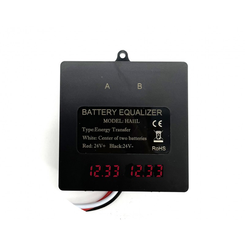

Hi all,
I currently have this setup:
Mecer Lobo IVR-2400LBKS with two Li batteries at 24V
Victron 100/50 SmartSolar charger with 3x 450W Panels
Can anyone share their Victron settings or look at mine to see if it's correctly configured?
I have the charging set at lower 28A as I scared of blowing the capacitors...

Set absorption to 28.8V and float to 26.8V. Do you have a balancer for the 2 x 12V connected in series batteries?
