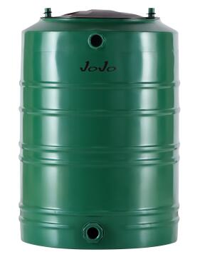

Just get a JOJO tank. Why a Geyser?

why not get the 260L jojo tank they under 1 meter
Thank you for the suggestion
Please could you point out the exact one ... the ones I looked at appeared to be too big ?
Please remember it needs to fit through a door AND be Horizontal
They not very big but might do the job.
or horizontal 240L jojo
Height 92.5cm
Width 62cm
Lol that's actually not a bad price they normally go for about R750-800
Typical Geyser Dimensions you looking at about:
200L
Height 134CM
Width 60 Cm
250L
Height 164CM
Width 60CM
So the Jojo is slightly fatter but shorter :)
