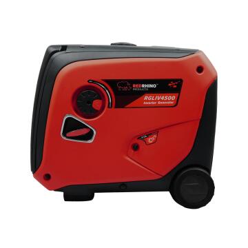

KantSnyer
Sep 4, 2015
2,048
Anybody have one of these .
How silent are they , and how cost effective is it running on LP gas
Was also checking this out yesterday, already have a backup for the house but looking for a portable backup option, the LP Gas option is interesting due to it's shelf life vs. petrol.
This is what I could find so far, obviously a rough estimate :
Running a generator with a 3000-watt load for an hour would consume 2.95l of propane.
