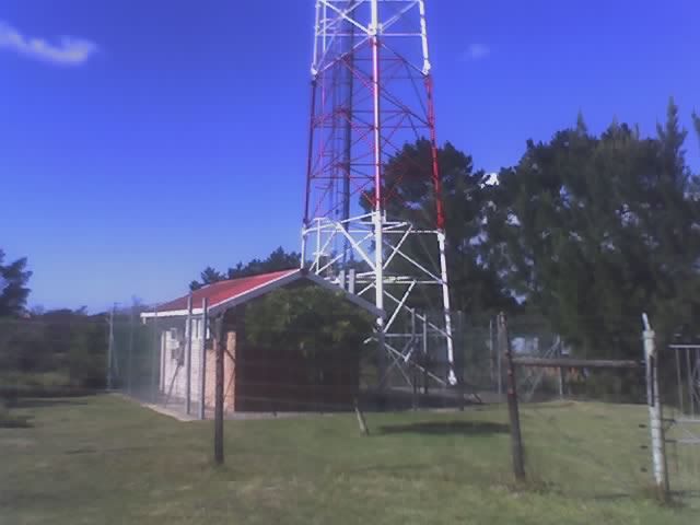

Just come back from a walk to this tower... even took some pictures of it :D here and here ...
Anyway if logo's are to be believed it's a MTN tower - just one very tiny little logo on the bottom - it would explain the full strength MTN signal around here though :)
Although standing at the base I get full Vodacom and MTN signals...
Do Vodacom and MTN share towers at all? I stand to be corrected but I believe they did for some time..

internaut
Senior Member
Oct 3, 2005
701
That's definately an MTN tower. Vodacom towers are the ones that look like huge dildos sometimes disguised as trees.

You would get full signal on Vodacom even though there is no tower. The tower is most likely located on a local peak (in height) so you are probably getting line of sight to a Vodacom tower some distance away.
Judging from the picture I assume you are not living in a town or city as towers in towns/cities normally have directional antennas - 3 long flat panels spaced equally w.r.t. angle.
Vodacom and MTN do share towers but not everywhere. If they share they only share the structure of the tower, not the antennas and radio equipment. I only see two omnidirectional antennas on that tower. On the shared towers I have seen, where both Vodacom and MTN have signs indicating so, there have always been at least 4 omnidirectional antennas on the structure.
Maybe putting your phone in the window may help getting a better signal, if the Vodacom tower is located in the direction your window faces. Otherwise an outside antenna will do the job.
Just on the edge of P.E. ;)
I've been thinking about an external antenna, I think it'll help quite a bit,
apart from that tower, there is another tower in direct line of sight, but it's kind of far away - probably about10KM - so an antenna might boost the signal a bit... :)
