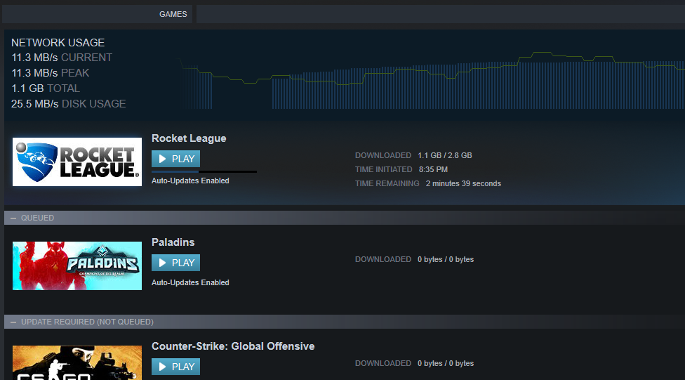

Indeed I do but that one was only on Telkom uncapped LTE and not adding the Rain bandwidth. Adding Rain gives me about 15.6MB/s download speed from steam

I use free software called Dispatch proxy that @Yuu mentioned to me. This software basically hosts a socks proxy which you then enter in windows or in a specific app if you wish that then push the connections from that app to the 2 connections I have namely Rain and Telkom LTE-A.
This does not load balance but merely direct each tcp connection to the a data connection. You can set priorities too like for ever 4 connections to Telkom LTE 2 will be to the Rain connection.
This works best with Multi threaded downloads in a download manager, steam or even torrents and usenet. Works well with browsing too as a single web pages has multiple elements too it like ads images ect ect so it splits them over the 2 connection meaning quicker loading times.
