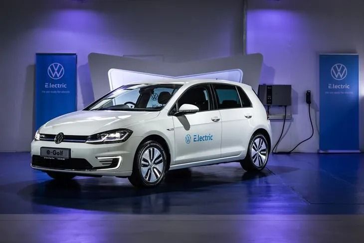

Volkswagen’s Electric Strategy Kicks off in SA
Volkswagen has launched the e-Golf pilot project in South Africa, which is the brand’s first step in its commitment towards electric mobility South Africa.
After Rwanda, South Africa is now the second country in Africa where Volkswagen electric vehicles are being introduced. VWSA welcomes a total of 6 fully electric e-Golfs to the country that will be tested by local media, selected dealerships and employees in an effort to gain insight into what it’s like to use and live with an electric car in South Africa.
In fact, Cars.co.za, will be testing the e-Golf extensively at our Head Office in Johannesburg, so look out for updates coming soon!
The e-Golf offers 100 kW and 290 Nm form its electric drivetrain which includes a 35.8 kWh battery. The e-Golf’s electric range is pegged at 190 km.
