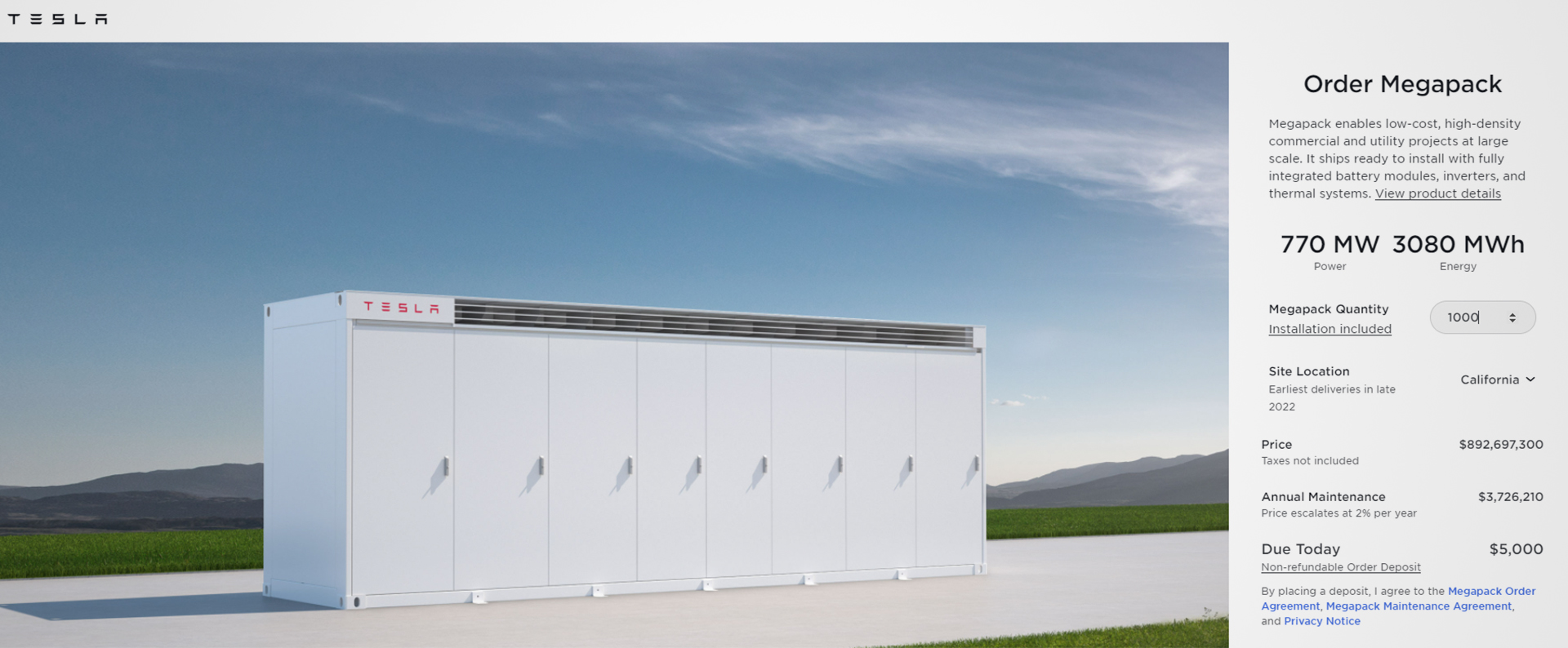

We calculated roughly how many Tesla Megapacks one could buy with Eskom’s battery budget.
At current exchange rates, R14 billion is around $960 million.
Tesla’s online configurator for the Megapack shows it charges about $1.26 million (R18.39 million) for a single Megapack with installation in California.
The price per unit declines with orders of larger quantities. Tesla’s website allows for a maximum of 1,000 Megapacks per order.
That would cost about $890.7 million, or just over R13 billion. On Eskom’s budget, it leaves another R1 billion for shipping and other costs.
It’s not clear how the batteries would be taxed.
However, such a system would be able to output at 770MW and boast storage of 3,080MWh — more than double what Eskom plans to procure with its R14 billion budget.
Eskom could stick to its original output and storage configuration by buying only 447 Megapacks, which would be sufficient to provide an output of 344.2MW and 1,376.8MWh of storage.
That would cost just over $399 million, or about R5.8 billion — less than half of Eskom’s planned spending on the system.
This would leave more than enough money for constructing 60MW of PV solar capacity, with billions to spare, assuming that installation will also form part of the R14 billion budget.
