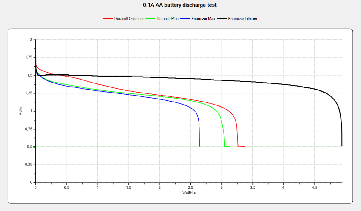

The low-current test discharges the cells at a constant 0.1A rate and ends when the voltage reaches 0.5V, indicating that it is empty.
This provides a good indication of the total capacity of the battery for devices that draw little power, such as remote controls.
Many devices may consider a battery empty closer to the 1V point, but we allow the tests to continue all the way to 0.5V to ensure a comprehensive view of the cell’s performance.

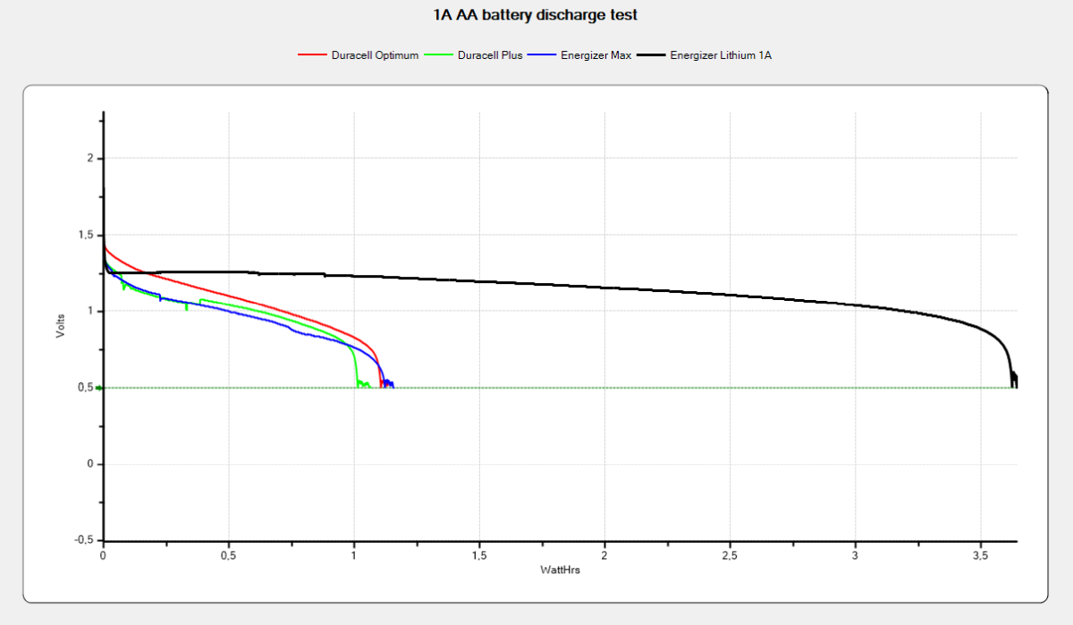

We also performed a discharge test at a consistent 1A to determine how they perform when a lot of power is needed. This is more in line with the current draw from flashlights or motorised devices.
Due to a battery’s internal resistance, it is limited in the total current it can supply. When more current is demanded from a battery than it can supply, the voltage will drop.
As a general rule, batteries will have less usable capacity at a high draw than at a low draw.
Battery drain test results
The Energizer Ultimate Lithium battery stood out among the rest in both tests. It performed significantly better than the alkaline batteries in the 1A test, with around three times the total capacity.
In the slower drain test, it reached almost double the capacity of some alkaline batteries. It also maintained a much higher voltage throughout both tests, which is useful for voltage-sensitive devices.
