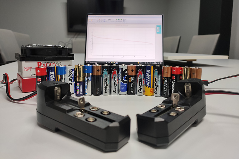

MyBroadband performed two discharge tests on the Duracell Optimum AA batteries and compared them to other brands.
The first test was at a constant current draw of 0.2A — a low current to simulate common household devices.
The second test was performed with a constant current draw of 1A — closer to what something like a powerful flashlight would consume.
The tests were done in an air-conditioned office with a computerised battery analyser to ensure accurate and comparable results.
Each battery was drained to 0.8V under load, which is a voltage at which many consumer products would stop working. It is a common standard to which most manufacturers rate their batteries.
During each test, the voltage was constantly monitored and recorded to calculate the battery’s total watt-hours capacity. This is the total power that the battery provided during the test.

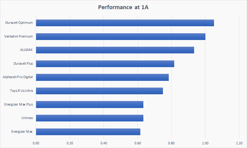

The results revealed that Duracell Optimum outperformed other alkaline batteries included in the test at both 0.2A and 1A current draws.
The chart below provides an overview of the performance of different battery brands at a lower and higher current draw.
These tests should, however, not be taken as absolute measurements but rather as a relative comparison between batteries.

MyBroadband calculated the price per watt-hour for each brand, which showed that Verbatim Premium offered the best value-for-money.
The chart below shows the price per watt-hour for each brand.
