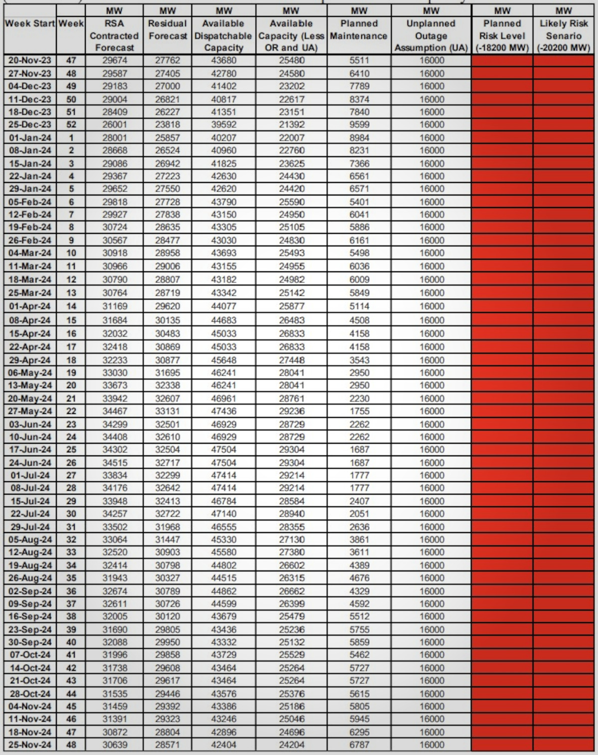

The risk of load-shedding between December 2023 and December 2024 is remarkably high, with Eskom anticipating it will be more than 2,000MW short to meet demand and reserves for at least the next year.
This is according to Eskom’s Generation Adequacy Report for the medium term, which gives insight into the risk of load-shedding based on “planned” and “likely” risk levels.
The outlook covers the 52 weeks from 20 November 2023 to 25 November 2024.
“The maintenance plan included in these assumptions includes a base scenario of outages (planned risk level),” Eskom explained in the report.
“As there is opportunity for further outages, these will be included. This ‘likely risk scenario’ includes an additional 1,500 MW of outages on the base plan.”
Under both the “planned” and “likely” risk scenarios, the power utility anticipates it will be at least 2,001MW short to meet demand and reserves during all 52 weeks of the year ahead.
To put this into perspective, a lack of 2,001MW of generation capacity translates to approximately Stage 2 load-shedding, depending on which other demand-reducing initiatives Eskom is running.
The power utility has also increased the anticipated lack of generation for each scenario.
Previously, Eskom’s “planned” risk level anticipated outages reaching 17,200MW. It has now increased this figure to 18,200MW.
The same can be said for the “likely” risk level — previously reported as 18,700MW and now reported as 20,200MW.
Eskom also changed its unplanned outage assumption, which indicates its assumed breakdown figures for the period.
In early 2023, Eskom reported this figure as 15,000MW throughout the year. It increased this to 16,000MW.
