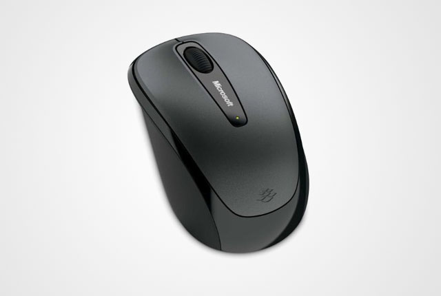

Mouse
Due to regular use and contact with sweaty or dirty hands, a mouse should be cleaned regularly.
Use a damp microfibre cloth to wipe down the device, making sure that no moisture works its way into the mouse.
Avoid using any harsh cleaning chemicals on your mouse, as this can damage its grip surface.
For crevices on the device, gently scrape away any dirt using a toothpick or thin plastic rod.
Microsoft mouse
