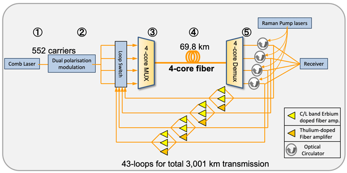

To enable long-distance transmission using S-band signals, NICT constructed an experimental recirculating transmission loop that combined two kinds of rare-earth-doped fibre amplifiers with Raman amplification.
This was distributed along the transmission fibre to boost the signal.
The schematic below illustrates the make-up of the transmission system used for testing.
The researchers explained the system exploited wavelength division multiplexing (WDM) and a combination of optical amplification technology to enable long-haul transmission of 552 WDM channels from 1487.8 nm to 1608.33 nm.
“The system was used to measure achievable transmission throughput with each channel modulated with PDM-16QAM modulation at distances up to 3,001 km, where a data rate of 319 terabits per second was achieved,” the NICT said.

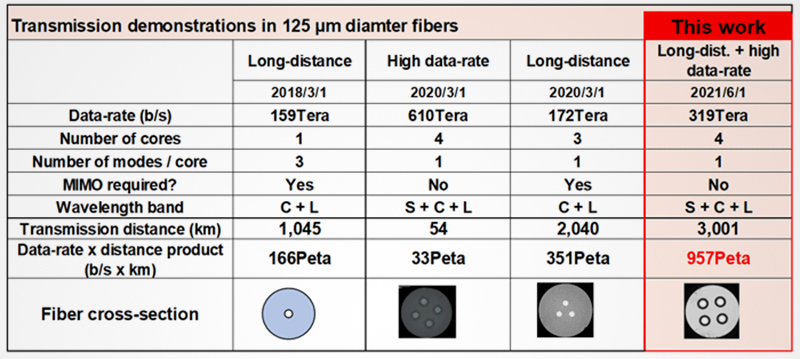

To compare this speed to other achievements in SDM fibres and transmission regimes, one can calculate and compare the product of transmission capacity and distance of the different solutions.
“The data rate times distance product becomes 957 petabits per second times km, which is over 2.7 times larger than previous demonstrations in SDM fibres with standard outer diameter,” the researchers said.

The table below compares the number of cores, different technologies, and performance metrics of the different combinations of technologies with the latest solution developed by the NICT.
