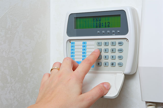

Alarm systems
Alarm system
  • Ensure your alarm system is always armed if you leave the house.
  • Arm your exterior beams at night.
  • Test your alarm system and panic buttons regularly with your security service provider.
  • Keep a panic button close by and ensure the family knows where it is situated.

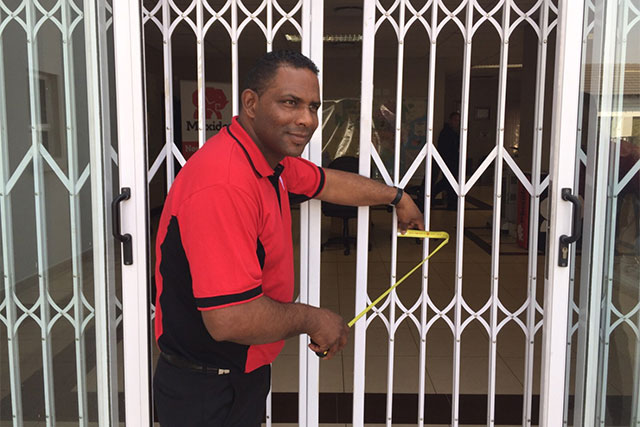

Security gates
Security door
  • Make sure you buy a security gate from a reputable dealer, and that it is made from tough materials.
  • Make sure any welding is done properly, that there are no weak points, and that the frame is solidly attached to the wall. Attaching it to a wooden door frame makes the gate weaker.
  • Make sure the hinges are strong and are the correct specification. Ensure the hinges cannot be accessed when the gate is closed.
  • Ask the installer to weld a plate over the length of the gate and over the frame to prevent anyone from inserting a crowbar between the gate and the frame. If you cannot install a plate, make sure the gap between the gate and the frame is as narrow as possible.
