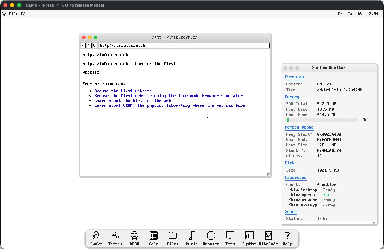

Using Gemini to explain bugs to Claude
VibeOS browser and system monitor

VibeOS only has USB and SD card drivers on the Raspberry Pi, so networking only works in QEMU. The OS has no memory protection and no system calls, meaning any program can do anything.
