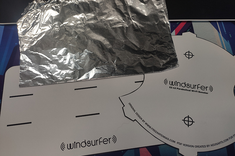

The Windsurfer reflector is easy to build. The design is printed on thin cardboard, cut out, covered in foil, and assembled.
Windsurfer components
