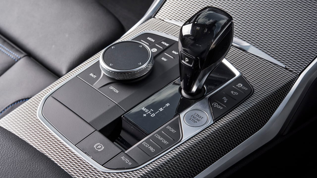

Change Our Mind #7: electric handbrakes are fine
Replacing a traditional bar with a fiddly button isn't evil, actually
In quite a lot of ways, I’m a dinosaur. The unexciting ways, naturally. I prefer hot hatches and supercars without turbos, no matter how otherworldly accelerative they feel with them. I like dials with an actual physical needle; their TFT replacements, to quote an Inbetweeners bit-part character, are ‘too jazzy’. And never quite as intuitive. Needless to say, gearboxes are always better with three pedals and no paddles.
But there’s one area where I’m totally happy to embrace change. The handbrake. It’s a common criticism of modern cars by self-proclaimed petrolheads every time they stumble into something designed and engineered post-2010.
‘Where’s the bloody handbrake gone?!’ the rant begins, as they begin to tear the concept of the little flicky electric parking brake button to shreds. Several writers I respect hugely and typically hang off every word of are guilty of it. I, though, just don’t care.
Perhaps my early days of driving were too timid. There were no attempts at handbrake turn heroics in closed supermarket car parks. I’ve no nostalgia about pulling a big lever in the middle of the car in a misguided attempt to pull an impressed onlooker. I’ve never been rallying (sadly) and I’d never aggressively use a handbrake while driving on road. Getting the best out of a front-driven car is so much more satisfying when it’s done by subtler means.
I’ll admit some electric handbrakes are a bit duff; they work best when they engage and disengage with some level of autonomy, sensing when you’ve stopped and immediately ungrappling themselves as soon as there’s a sliver of movement from the wheels as you pull away.
There are plenty of examples of e-brakes that miss the mark, the biggest bugbear being when they don’t work hand-in-hand stop/start systems. If you frequently drive in an urban environment, there’s little more frustrating in a modern car than an engine that chunters straight back to life when you attempt to wait at traffic lights with the handbrake on rather than blinding the driver behind by sitting on the brake pedal. Laziness shouldn’t be encouraged.
