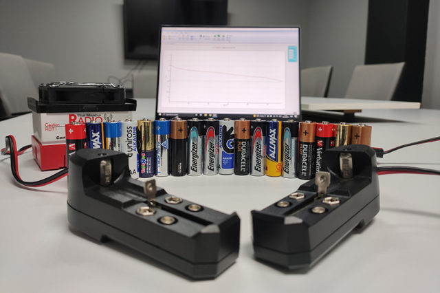

MyBroadband performed two discharge tests on the Duracell Optimum AA batteries and compared them to other brands.
The first test was at a constant current draw of 0.2A — a low current to simulate common household devices.
The second test was performed with a constant current draw of 1A — closer to what something like a powerful flashlight would consume.
The tests were done in an air-conditioned office with a computerised battery analyser to ensure accurate and comparable results.
Each battery was drained to 0.8V under load, which is a voltage at which many consumer products would stop working. It is a common standard to which most manufacturers rate their batteries.
During each test, the voltage was constantly monitored and recorded to calculate the battery’s total watt-hours capacity. This is the total power that the battery provided during the test.
