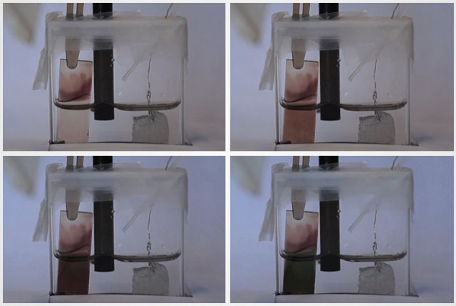

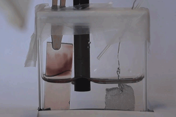

The MIT team overcame that by using sponge-like materials called metal-organic frameworks (MOFs), which can conduct both electrons and ions at very high speeds.
Such materials have been used for about 20 years for their ability to store gases within their structure, but the MIT team was the first to harness them for their electrical and optical properties.
The other problem with existing versions of self-shading materials, Dincă says, is that “it’s hard to get a material that changes from completely transparent to, let’s say, completely black.”
Even the windows in the 787 can only change to a dark shade of green, rather than becoming opaque.
In previous research on MOFs, Dincă and his students had made material that could turn from clear to shades of blue or green, but in this newly reported work they have achieved the long-sought goal of producing a coating that can go all the way from perfectly clear to nearly black (achieved by blending two complementary colors, green and red).
The new material is made by combining two chemical compounds, an organic material and a metal salt. Once mixed, these self-assemble into a thin film of the switchable material.
