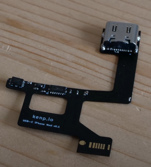

In a recent video posted on YouTube, Kenny Pillonel provides a teaser of a working iPhone X he had modified to support charging and data transfers via a USB-C cable.
The video illustrates the iPhone charging with a MacBook’s USB-C cable connected to a power brick and being detected when plugged into the MacBook with the cable.
Pillonel explained that he reverse-engineered the iPhone’s C94 connector with its Lightning standard to make a flexible PCB (printed circuit board) with a USB-C port.
Once he had drawn up the schematics, he had to shrink the design down, remove the Lightning connector, and install his own creation.
Below are screenshots from the video showing the iPhone X’s USB-C port and proof that it charges.

A blog post from May details his thinking behind the replacement and the issues he would face replacing the Lightning port.
He also posted a video of a prototype that could charge the iPhone but was still too big to fit into the phone’s enclosure.
In an update in late September, he said he ordered the flexible PCB required to make the compact iteration of his design.
