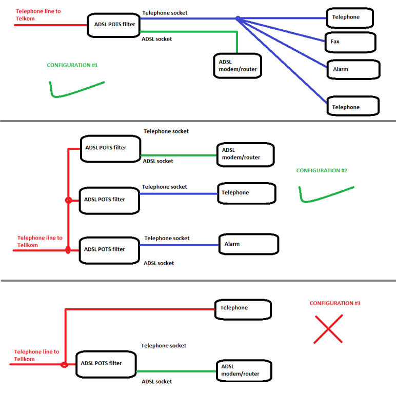

Here are a few different configurations of POTS filters (that I've drawn myself): http://www.mediafire.com/imgbnc.php/7d0a1f55d9a0eb42df4325fc3d5ad62e6g.jpg
And here's a link that explains ADSL filters: http://www.epanorama.net/documents/telecom/adsl_filter.html
Each of the POTS filters you have drawn appears to have two ports on it. The filter I have is connected to one of the two "wall" sockets, but the filter itself has only ONE socket, into which the fax/phone is plugged. Therein, I suspect, lies the confusion.
Yes I know I draw only the ones with 2 sockets, but you get filters with only 1 socket one each side (1 in and 1 out). You'll have to find out if its a low pass filter (for the telephone) or a band/high pass filter (for ADSL).
I just wanted to show how you should connect multiple devices on a single filter, etc.
