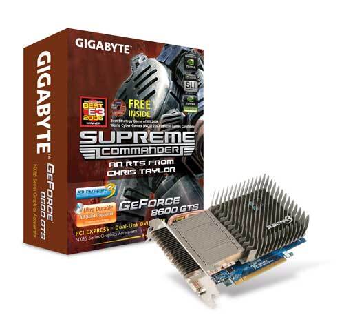

Actually had to do this back in the day. Bought a Gigabyte 8600GTS featuring "Silent pipe" cooling, idea being to be passively and silently cooled. Load of arse. Ended up just bolting a 120mm case fan to it. GPU finally worked as expected.
