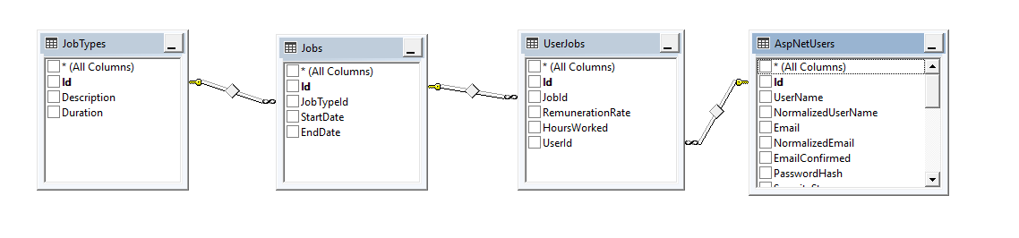

Just coming back to this. This is the basic table structure. There are others but really this the heart of it all. It is open to suggestions/name changes/pie flinging. Come at me bros.
I have the remuneration rate in two places, one in the Users table and another in UserJobs (worst fkn name ever) because I want the option to change their rate when I see fit, or feel like it basically.
Don't forget that attributes such as password and email address could very well be linked more to the user's role than the actual user i.e. be very careful when deciding where to store the data.
I would probably store any such attributes in their own entity tables, along with a link entity that includes a user ID and a role ID.

Edit: Thanks rrh I will just need to think about that or put on todo list. Smashing this project to get it finished and then will come back to that before I go forward.
Edit: FYI this is on the API side. I have limited what data is returned when polling user information to basically this:
