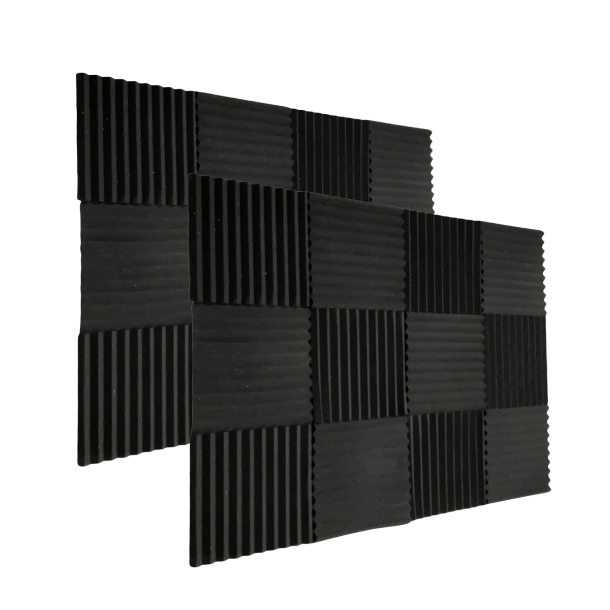

Looking for something to absorb echo in an open area/room. Anyone used or can recommend something like below?
Home. Tiled area around 40sqm, will be used for teaching school kids.
Get them off TEMU. I got them at 400 bucks per 48-pack. Free shipping as well.
These will work fine for high frequency sound absorption. Just keep in mind you will need to cover a lot of surface area to get any benefit in a classroom environment. I'd say at least 40% of your wall area. And that includes the ceiling.
Reason being that there is not just one listening position so you need to cover every first reflection point for all listening positions. Which basically means you need to spread them out over the entire room rather than placing them in certain areas.

He's not building a studio. Standing waves occur with low bass frequencies. Those are not gonna be present in a classroom.
Those TEMU panels will do perfectly fine to eradicate high frequency reverb in a tiled room.
Buying expensive studio gear or even doing studio-level DIY for this application would be a total waste of time and money.
Again, overkill and a waste of time and money.
Bass frequencies are not an issue.
Those TEMU panels would still work out cheaper.
If you really wanna DIY then you can try find old curtains for free. The thicker the better. Hanging curtains along all 4 walls will definitely do the trick as well. Though you still need to sort out the ceiling.
Or if you wanna go really bergie you could even pin old clothes to the walls. Could look quite interesting... :ROFL:
