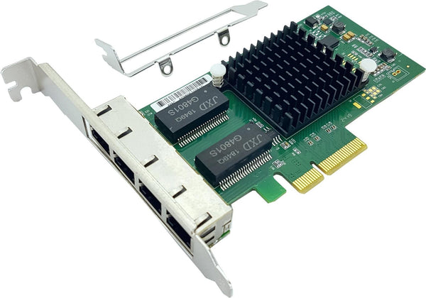

DIY miniPC. Far more flexibility, expandability, extensibility and choice.
The Going Idea at the moment was OPNsense + Zenarmor.
I had a minipc but the guy dropped out . so i need to look for one with dual nics again .
Doesnt seem to be an easy thing to find .
Get a micro ATX board and small case, use these guys for a NIC, they also do dual NICs:
