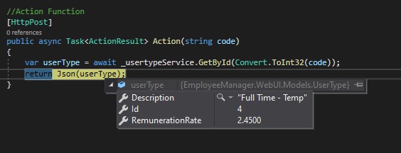

What is being returned from usertypes service

Ok this actually works now.
Code:
<script type="text/javascript">
function Action(code) {
    $.ajax({
        url: '@Url.Action("Action", "User")',
        type: "GET",
        data: { "code": code },
        contentType: "application/json",
        dataType: "json",
        "success": function (data) {
            if (data != null) {
                $("#remRate").val(data);
</script>
Code:
[HttpGet]
public async Task<ActionResult> Action(string code)
    var userType = await _usertypeService.GetById(Convert.ToInt32(code));
    return Json(userType.RemunerationRate);

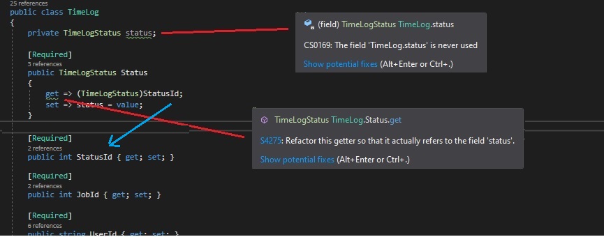

I have a TimeLog class with a StatusId property. The statusId is sourced from an in project Enum:

In the TimeLog class I have done this. It works by the way but Intellisense is not happy with the way I have done it.
Like I said it works, but it's like "wtf bro" and I'm not sure how to resolve this. I've tried a few different things but all of them with egg on face.
Change your setter to set the StatusId property and remove the private field.
so then your Status property is just a way to convert an int to a TimeLogStatus and vice versa.
I personally do not use int based enums, as they are impossible to read, say in a database, and if you want to insert another enum value, your existing items are broken because 2 is now 3

Thank-you Kabal!!! Hey I didn't even consider that but a very good point; no way of knowing what it is in the DB. So just a straight forward string based enum then?

Yes. And if you are using EF core (dapper too probably) then it can auto convert from enum to varchar and back, so you don’t need to expose the string property
Nice one awesome thanks I will have a look at this in my project :thumbsup:
