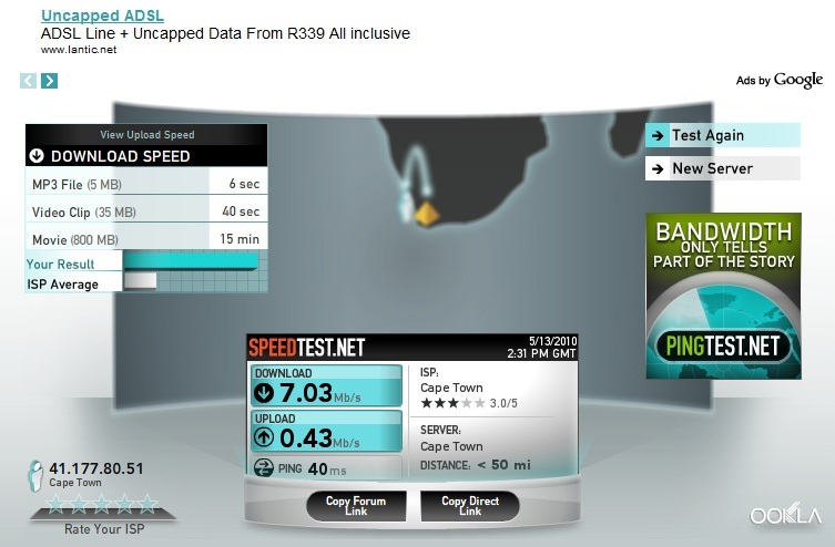

Thanks for the explanation Laurie.
Weekends speeds are terrible now but in the week I got 7Mbps so hopefully the weekend will improve soon!
(Can I put this image inline?)

How did you get 7Mbps? I thought the max was 4Mbps?

10Mbit is being rolled out. If your line doesn't support 10Mbit it will go down to 9,8,7,6,5 ect ect to the rate your line can handle. So it might be this.
