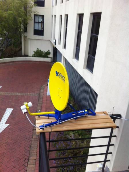

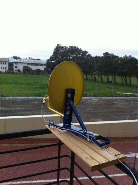

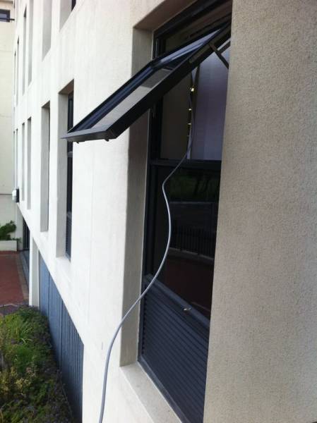

We eventually got it right. Couple of lessons learned:
1) Use www.dishpointer.com to narrow down your aiming
2) It doesn't work through the office window ;)
3) Sticking it out the back door under the stairs still wasn't good enough, it had to be out under clear sky
4) Yes it really does need to be aimed finely
5) Once you have good signal strength, turn your LNB up/down to get your signal quality up.
6) This will drive a HD PVR decoder with a HDTV DVB-S2 40mm LNB
Some pics:
