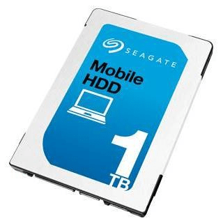

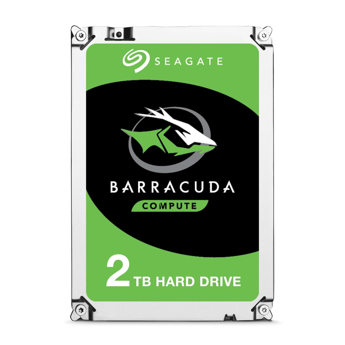

Hello,
Looking for some recommendations on a new HDD for my laptop.
My laptop started making a clicking noise yesterday. After checking everything I can, muting sound etc...
I think it is my hard drive making noise. I will try and remove it on the weekend and see if the noise stops.
I have a SSD for booting up - this is my data drive.
Looking to replace it with a 1TB or 2TB depending on price. Currently a 1TB.
Laptop: Lenovo Y410P
Part Number: ST1000LM024 HN-M101MBB
***Not sure if these will work or any better ones/cost effective ones on the market - recommendations appreciated.
1TB on Takealot - 2TB on Takealot -
***This one is a 7200RPM and I think mine is a 5400RPM - not sure if it will work with my laptop and be a better choice?
Not my picture - from the internet for my laptop.
