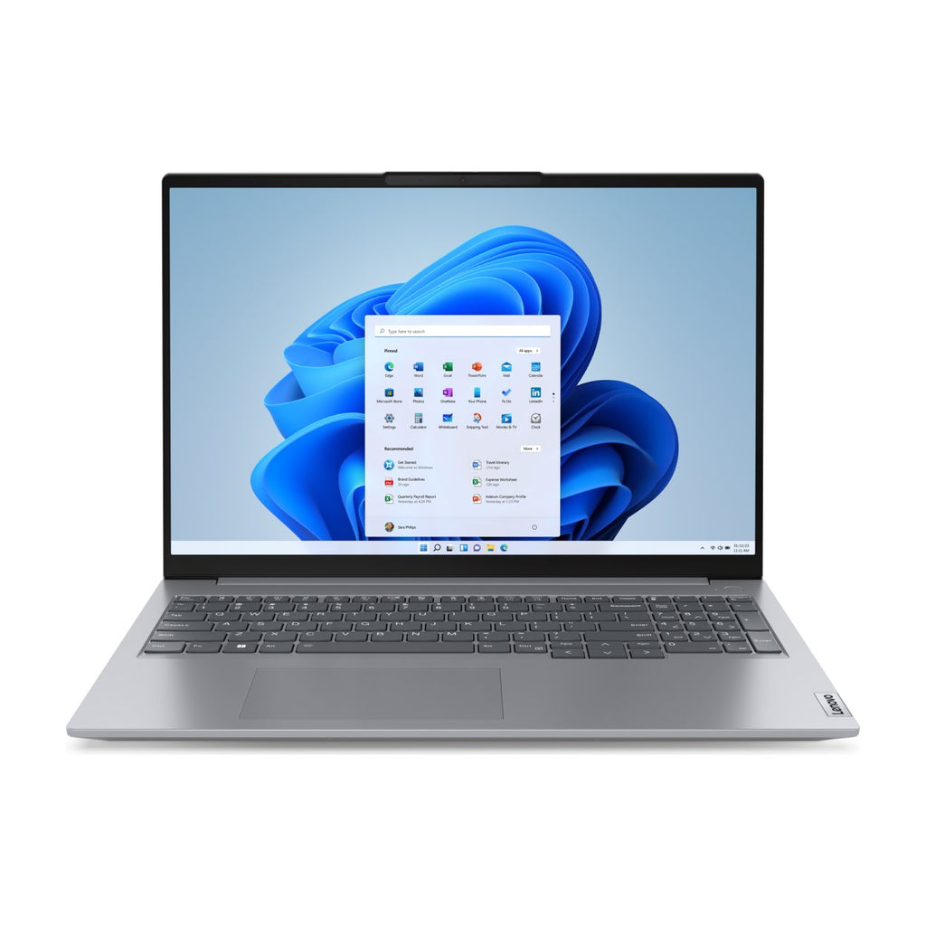

What's the make and model number of the laptop? Generally though it's not possible, unless it also has a display port or type C with video out
Lenovo Thinkbook 16 G6
This one?
If it's that one then you could use something like this
But if you open the Lenovo support website and put in your serial number it should give you the exact model. You are looking for Type C with display
On that spec page it's listed as
  • 2x USB-C 3.2 Gen 2 (support data transfer, Power Delivery 3.0 and DisplayPort 1.4)

This is listed under Specs when I type my SN in:
1 x USB 3.2 Gen2 Full Function Type-C (USB+DP+PD); TBT 4.0; 1 x USB 3.2 Gen1 Type A; 1xUSB 3.2 Gen1 USB Type-A with AOU

Yup that's perfect
