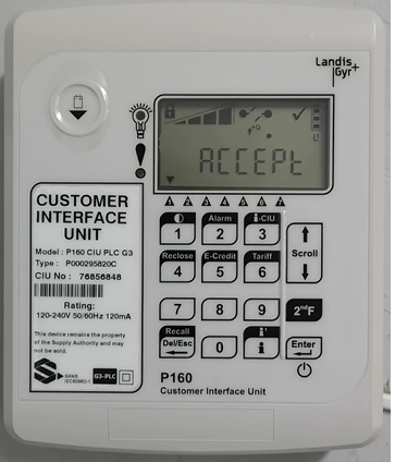

The CIU is supposed to use less than 1 watt
Also, please mask out your CIU number from that photo...
So definitely less than the ~60W being used on the 1.4kWh day.
PS. - that's a pic from google, not mine.
