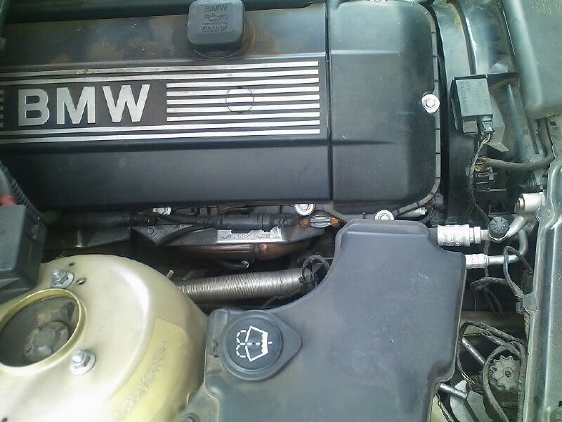

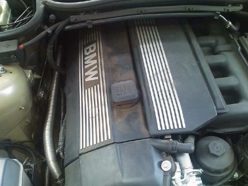

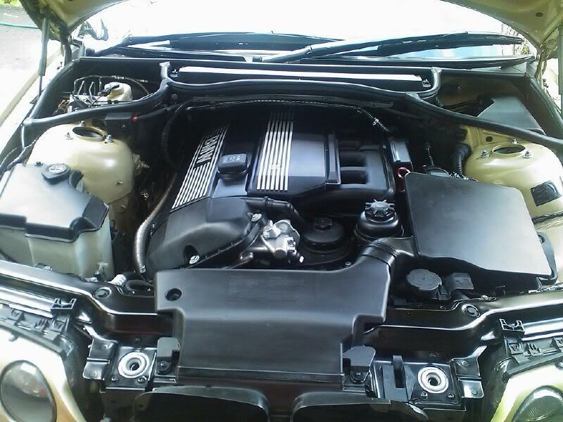

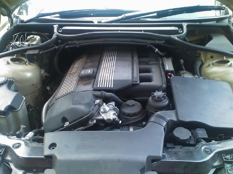

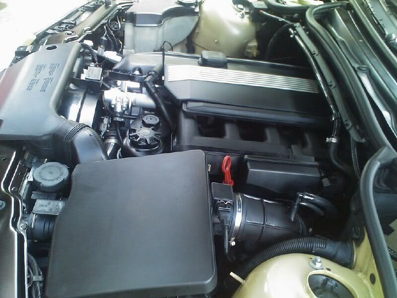

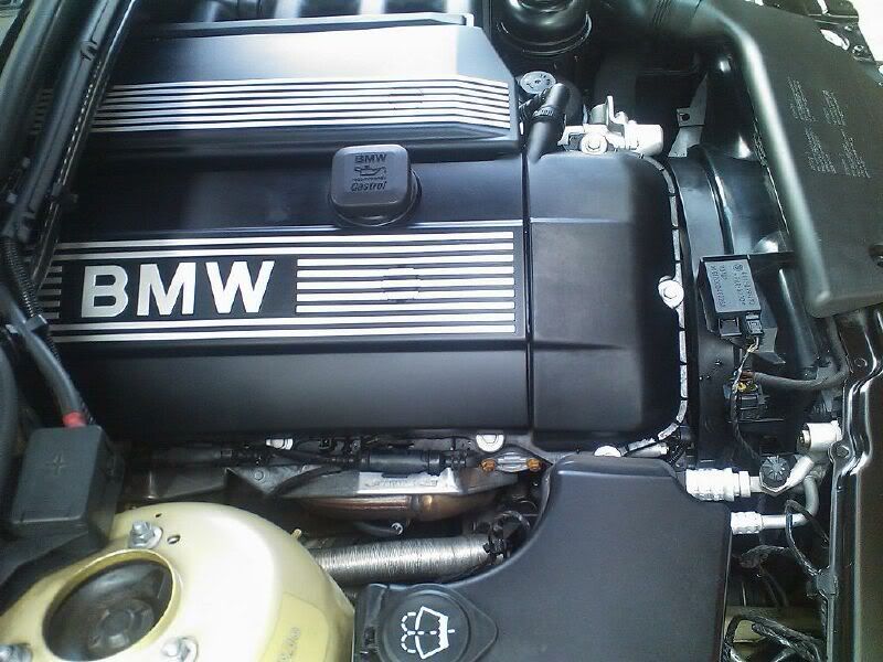

The last time I did an engine detail, I sprayed the engine bay down with the Sonax engine cleaner and let it sit for about 5 mins. Some of the really soiled bits were lightly agitated with a soft brush. Then I took my 2L pump sprayer and set it to "stream" instead of spray. This gave me more control on where the water went. With the hard work already done by the chemical and brush, all I was basically doing was a very light rinse. The last thing you want to do is wet the electrical parts. :( Once properly rinsed off, you can leave it to air dry, but I prefer to idle the car for a while as the heat from the engine helps to dry it quicker. Lastly you can treat all plastic bits with a bit of trim detailer. Make sure its not silicone based as that tends to attract dust. Once treated remember to followup with a light buff to remove excess product. Very important step as excess product that is not dry to the touch will also attract dust!
Some of the pics I snaped during the process:
Befores:
Afters:
